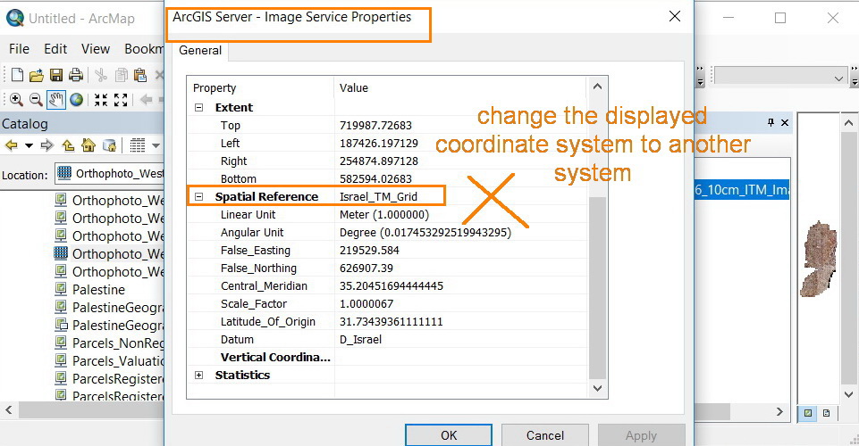

I am wondering how can I change the coordinate system for published image service?

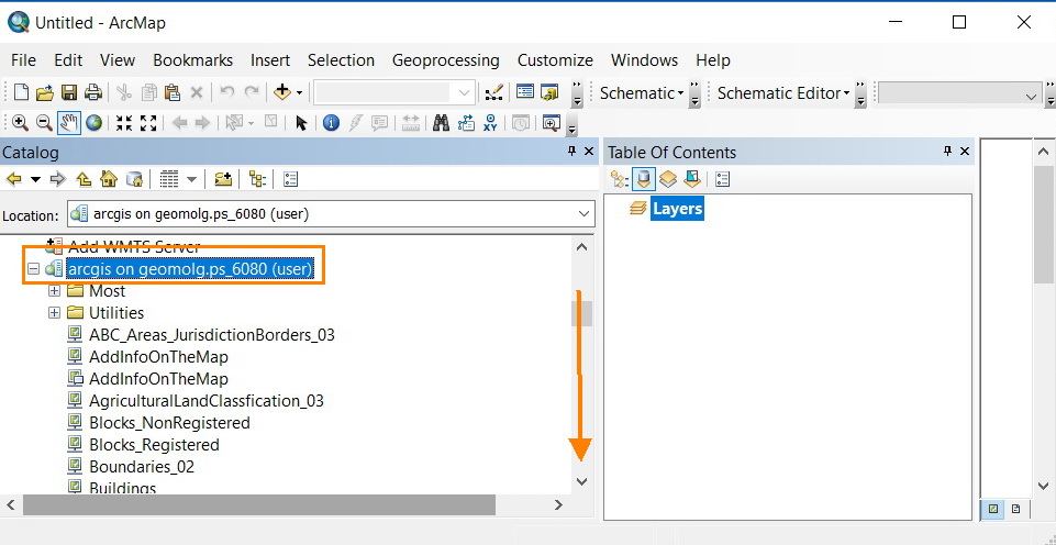

I read this service from public ArcGIS Server: http://geomolg.ps:6080/arcgis/services

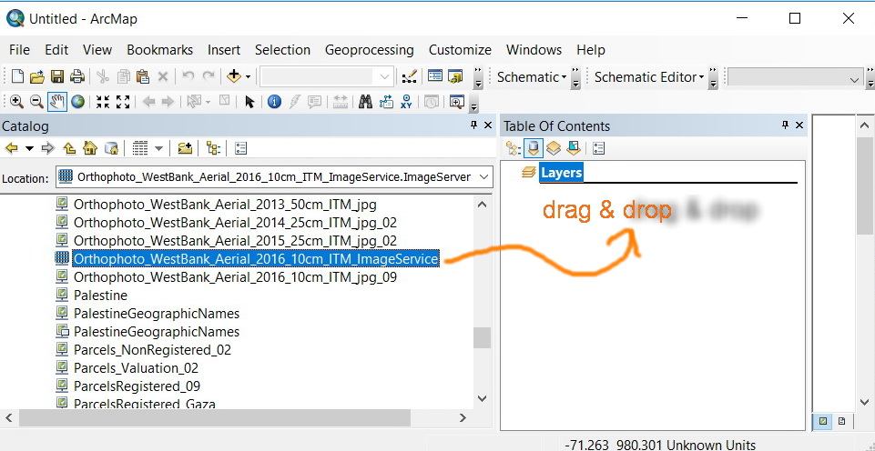

However, when I drag & drop this service, this service took its original coordinate system.
How can I change the current coordinate system in my data-frame, so I can download study zone from this image service with wanted coordinate?
Kindly find the attached screenshots.
Thank you in Advance.
Fatin Rimawi

Open a blank map.
Define the coordinate system of the data frame.
Then add the image service to Table of Contents.
The map service will be transformed on-the-fly according to the coordinate system of the data frame.
Note: The coordinate system of the image service won't change in the above process.

FatinRimawi
Hi Jayanta,
Thank you for your replay.
I am aware of transformation method.
My point here is changing the coordinate system of the image service itself.
What do you think?
