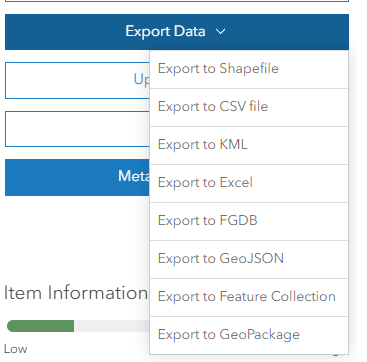

open the overview page of the hosted feature layer, go to Export Data
Select Export to FGDB
fill in the form
Then download the GDB

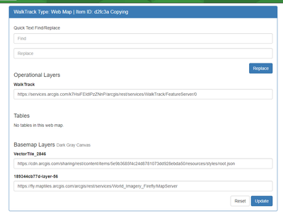

what is left to do is to reconfigure your maps to use the new service instead of the old service you do this by using ArcGIS Online Assistant (esri.com)
log into ago-assistant navigate to the maps that use the url and update the url with the new url, if the layer order has changed then make sure you change the layer order as well
select  Update the URLs of Services in a Web Map
update your Operational Layers with your new url, you will have to edit the JSON if you want to update the itemid aswell
