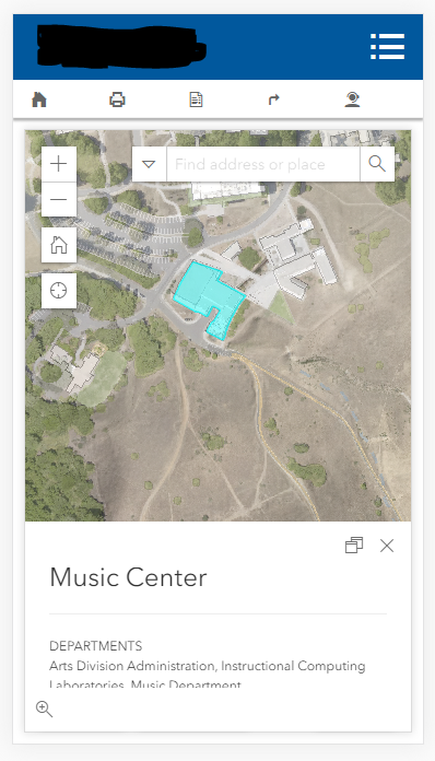

The frustrating part is that it works as expected in Chrome Developer Tools (below)

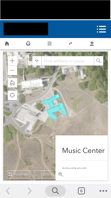

But it doesn't work on my mobile device!
This is a screenshot of the current behavior from my mobile device using Google Chrome.
screenshot
It seems to be docked in the lower-right corner since when I pan around the view, the pop-up stays put.

So it looks like it was my mobile device OS that was causing unexpected behavior.
I updated my device OS and got the behavior I was expecting, with the popup docking bottom center.
I suppose I can't force everyone to update their OS, but might include a disclaimer about unexpected behavior with an old OS.
