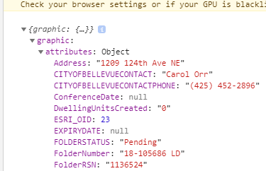

And logging the 'info' parameter - below is first feature, and 2nd image is the second feature returned after paging...
