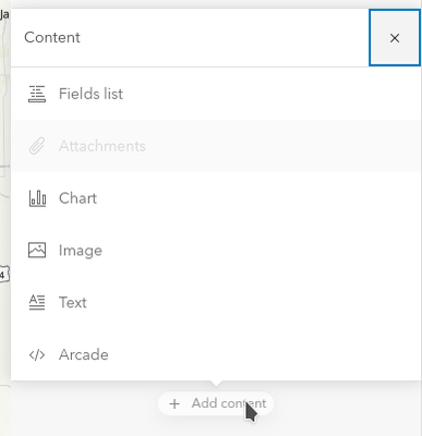

If you're building a popup, you really ought to consider using an Arcade element, rather than returning a string. You are essentially building a fields list, so why not doing it directly? Under add content in the popup menu, choose an Arcade element:
The output of that code block will be a bit different, but it's not too hard. For the null situation, we can return a simple line of text, but we can bring your two desired attributes into a field list otherwise.
