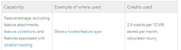

Feature Storage is calculated at the organizational level, and not per user: Configure credits—ArcGIS Online Help | Documentation. With that in mind, we know that any difference between assigned and available credits would come from transactions (e.g. analysis or geocoding).
For the credits per hour calculation, since it's 2.4 for 10MB over a month,that shakes out to about .0033 credits/hr for 10MB of storage.
