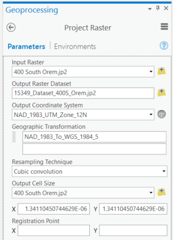

I was wondering about that. The cell size did seem extremely small. I am wondering why that is.
Here is some info:
original file is a jp2 image natively in WGS84 and sits at around 12.3 MB in my folder:
and
Looking at this data, the cell size IS really small but I am wondering if that is represented in decimal degrees and not what my map is in (which is meters). If I change the cell size to this:
which is what the cell size is in meters (for my map's system of NAD83 UTM Zone 12N)
Then, it runs just fine and produces the file as expected. The new file is around 25.9 MB in my folder - same jp2 extension.

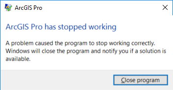

Out of curiosity, I tried to run the same process with the original default values in a WGS84 map with degrees as the map units (and the super small cell size). It crashed on me again. I wish there were an error message at least!
Thanks for pointing out the cell size issue!
