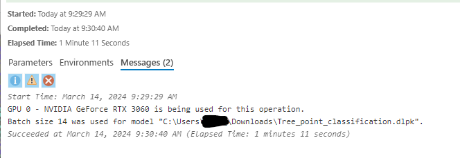

The short version is that when I run 'Classify Point Cloud Using Trained Model' on a .lasd file using the tree point classification deep learning pack, the point cloud is unaltered; the point classifications remain the same. The output indicates a success and there are no errors or warnings.

I downloaded the tree classification pack and used it in the 'Classify Point Cloud Using Trained Model' tool numerous times, changing minor details here and there. A few of the things I've tried: I made a LAS dataset and loaded of the .las files into this dataset and used it in the tool, but I've also used the individual .las files as well. I've tried turning on each one of the target classification classes, using a processing boundary, downloading the tree classification package once again. I updated ArcGIS Pro to the latest version, redownloaded the deep learning installer for Pro 3.2, and restarted my computer. Every time I run it I get the same success message from the tool (screenshot below).
