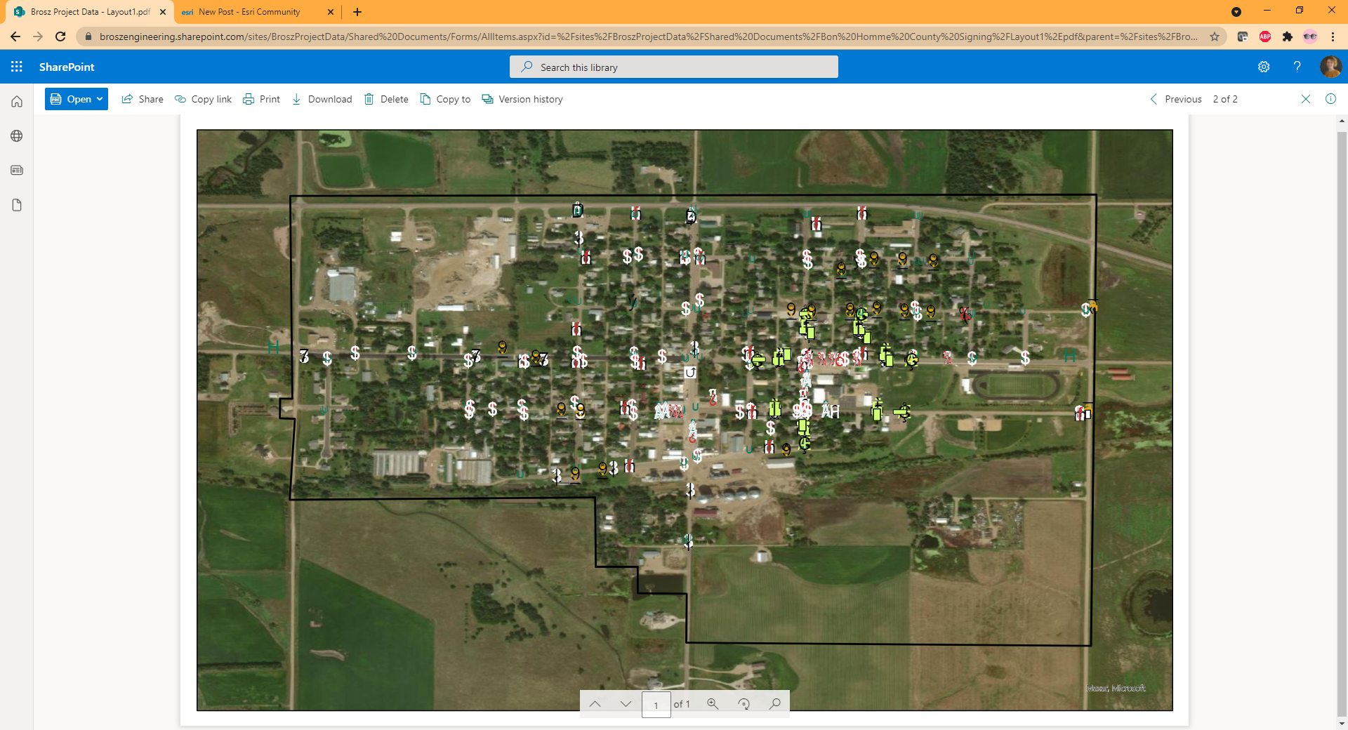

I am totally stumped. When I export a layout in ArcGIS Pro as a PDF, it shows up normal as the original copy on my desktop. However, when I copy it to a shared folder anywhere, it opens with bizarre symbols like it's corrupt. I'll attach a screenshot, but I can't figure out what is happening.
It sounds like a font issue. Your machine would have access to the same fonts that Pro does, so it wouldn't be a problem, but another machine / web interface that lacks those fonts would not display it correctly.
In your export settings, is "Embed Fonts" checked?
