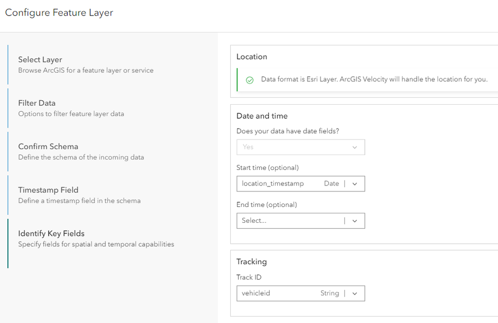

- For the Identify Key Fields step, verify the default values match the settings below:
- Click Complete to finish updating the configuration settings for your VehicleTracks input layer.
