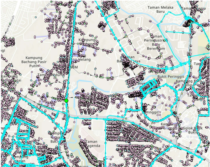

@NadiaAlami The answer to this is similar to the answer to your other post about downstream tracing. Your water distribution system, like most, is heavily looped. An upstream trace shows you all the potential paths that water can take to get to a location, so the result returned is correct, even if some paths are only contributing a small fraction of a percent of water.
It sounds like you want to see the shortest path to your subnetwork controller, which you can accomplish by running a subnetwork controller trace then running a shortest path trace between your subnetwork controllers. The shortest path trace will find the shortest path between ONLY TWO points, so if you have multiple controllers you will need to either pick just one of them or iterate through all of them and merge the results.
