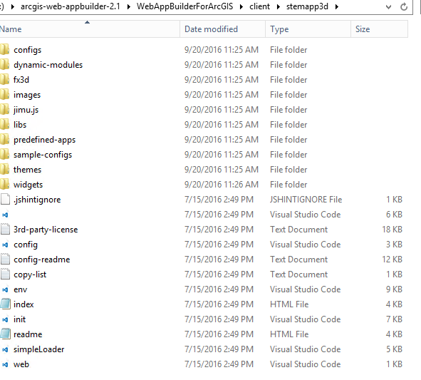

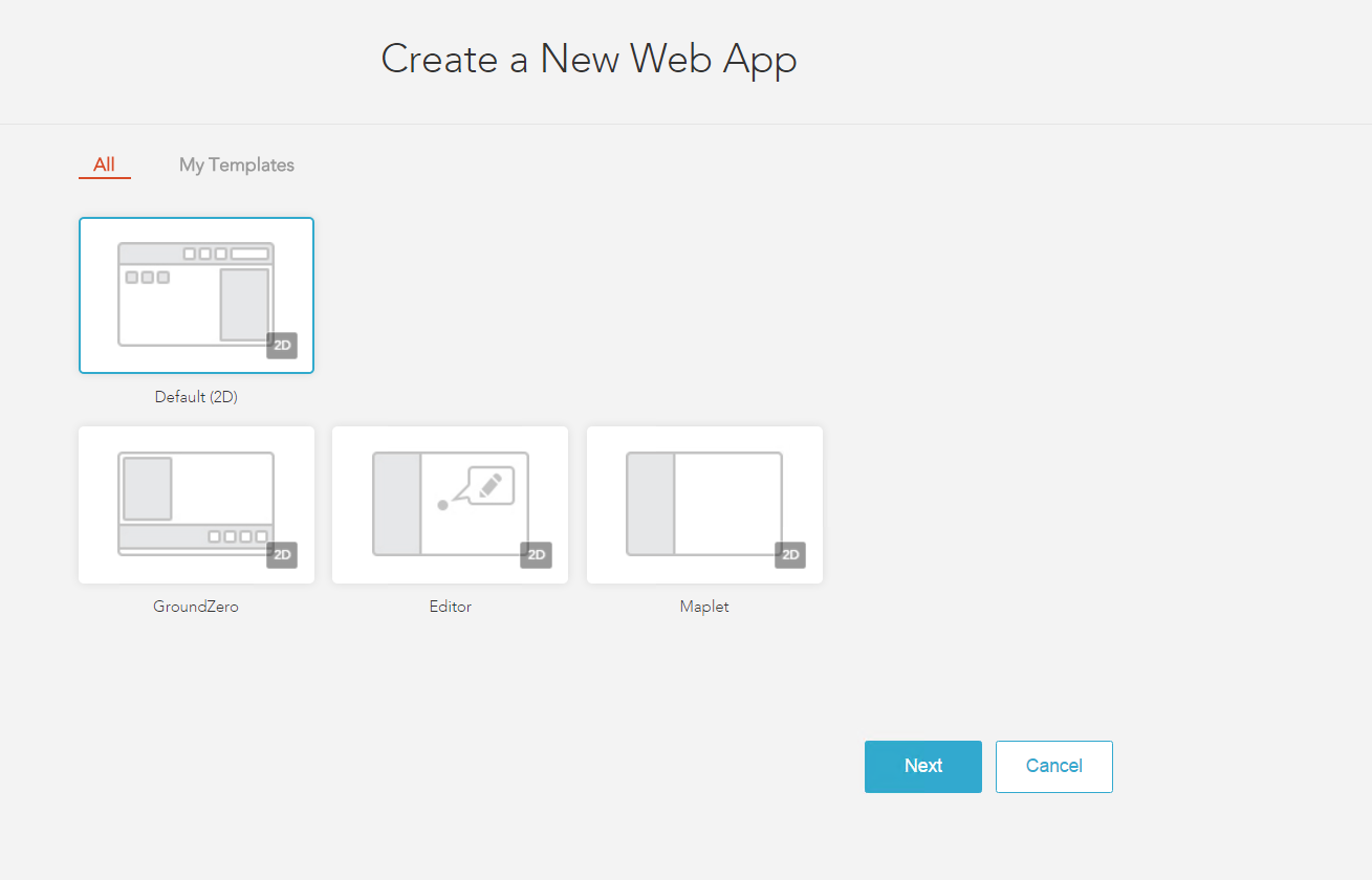

I am using Web AppBuilder Developer Edition 2.1, but I am missing the Default (3D) template when I try to make a new app. There is a client/stemapp3d folder in the install. Has anyone experienced this or know the best step to start troubleshooting this?

I think the reason is your portal does not support 3D. Only 10.3.1 or higher version support 3D app, could you check your portal version?
Correct! That's the issue. Thanks!
