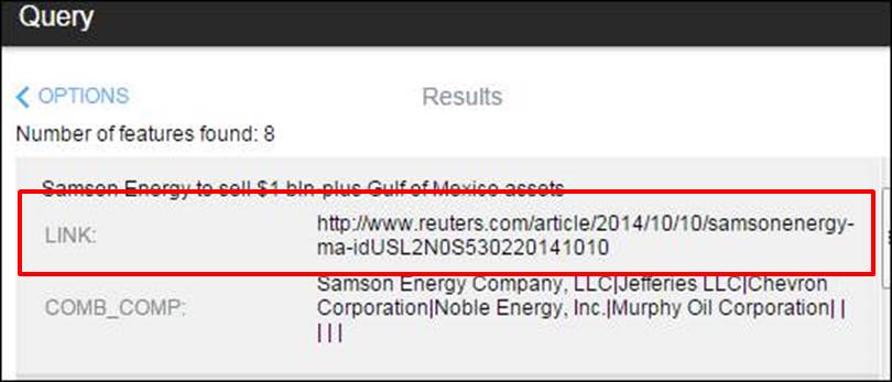

In the query widget in the Web AppBuilder, I am trying to get one of the result fields to display as a hyperlink, but I am having trouble.

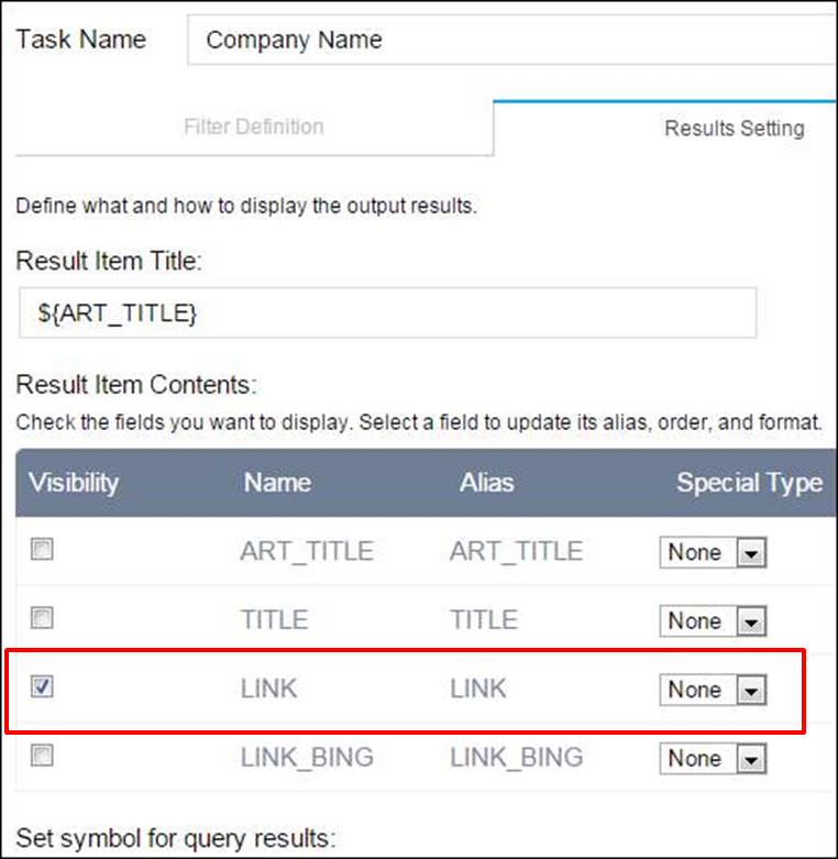

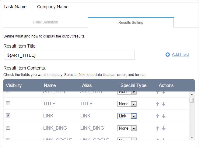

In the “Results Setting” tab in the query widget, I’ve set the URL field’s Special Type as “Link”. I click OK and save the Web App.

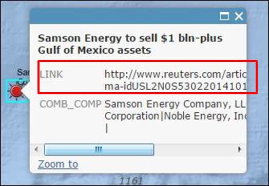

When the query is run, the results display the field, but the hyperlink is not active. Nor is the hyperlink active in the pop up when one of these results is clicked on the map.

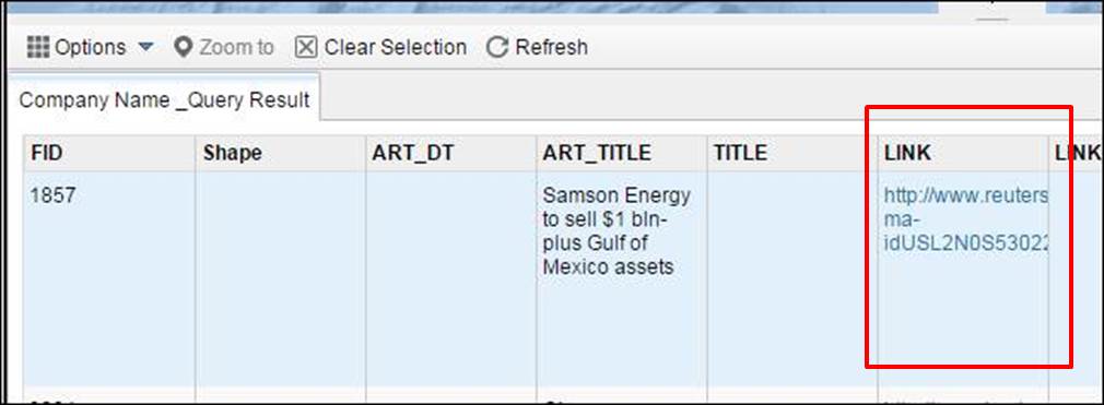

However, the link is active if the result layer’s attribute table is open.
If I go back to edit mode in the query widget, the Special Type for the field is back to “None”. The “Link” type does not hold.
Is there a way to get the Special Type to remain “Link”? I don’t believe it is a problem with the URL itself, as the hyperlink is activated and working in the attribute table.

The problem is not with the layer's pop-up, but with the query result layer's pop-up (which isn't a layer until the query widget is run in the web app). It is my understanding that this pop-up is configured in the edit mode of the query widget, under the "Results Settings" tab.
