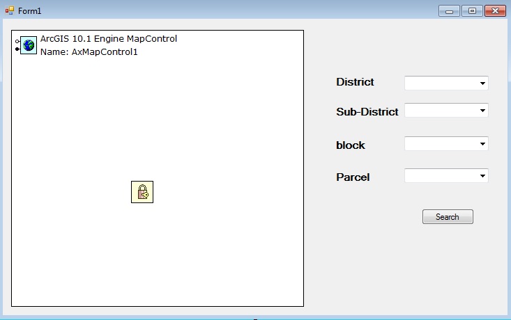

I am working now on ArcObject (.NET) stand alone application , i need to get the parcel for certain area through filtering technique (4 levels ) district , sub-district , block , parcel
each one represent by layer (separate) , what is the code will be use to retrieve the information then focus on the parcel area (target)  , all layers are polygons ....

Mainly   this what i need , through the filter  each ComboBox select value will filter based on it and so on , appreciate what you write but i need your help to get the suitable code that i need it to do this function (plz help me ) and in the same time many people will like and they will benefit from this article ..
Note i have 4 layers as shown in the application .(polygon)

Thanks for your feedback , really i appreciate  what you did , thanks a  , i problem what i face it is i don't have for research because i have many things to do it not this function only ...
I will test it and then i will give the feedback ...

Dear Mr.John
Really it's work fine  with me without any problem , many thanks for you >>>>
