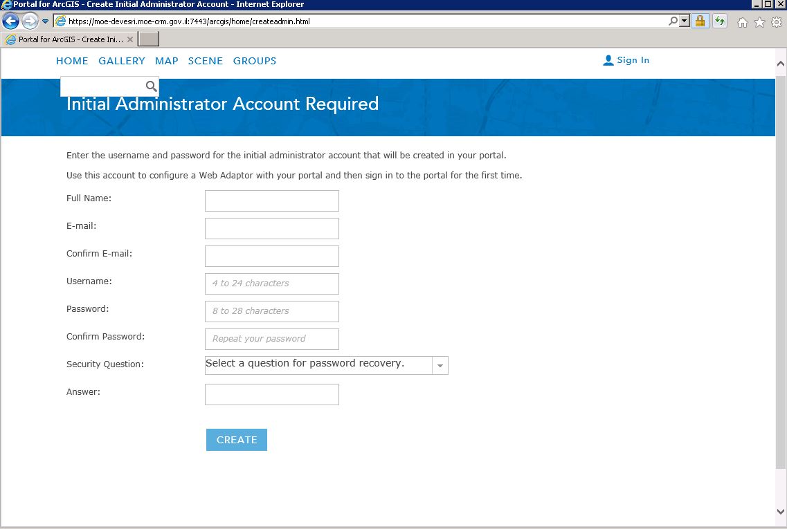

It's been a week now since we upgraded our version from 10.3 to 10.3.1 and right after the upgrade we had many visual problems when browsing the portal on IE, such as bad width of the top menu bar when the "My organization" button shows up in 2 lines, the search bar shows up always on the left side beneath the menu bar instead of being at the right side, maps got scrambled like a puzzle in a very weird way and more... see attached screenshots

Installed it again, and the same problems shows up! - no scrambled maps, but all other visual problems I've mentioned (see attach screenshots).
Removed everything again! installed IE version 11 and then tried to reinstall the portal again, and still nothing changed - you can see it's wrong immediately at the first portal window when he asks to create a new user - first screenshot.

Screenshots -
First screen right after a clean installation -
