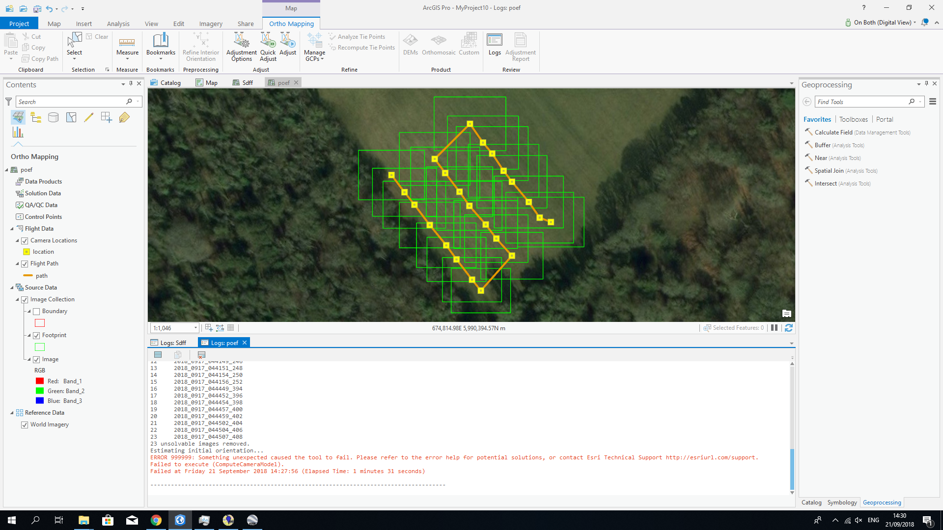

Hi Everyone, New user to Arcgis Pro and having inconsistent results trying to produce orthomosaics.
Error 999999 Computecameramodel
The error code is 999999 and the error message is failed to execute "ComputeCameraModel".
I tried working with a smaller sample of images. The camera used is the Mapir Survey 3N and I have populated the camera parameters with the correct Focal length, Pixel size and columns and rows.
Here is a copy of the logs.

23 unsolvable images removed.
Estimating initial orientation...
ERROR 999999: Something unexpected caused the tool to fail. Please refer to the error help for potential solutions, or contact Esri Technical Support http://esriurl.com/support.
Failed to execute (ComputeCameraModel).
Failed at Friday 21 September 2018 14:27:56 (Elapsed Time: 1 minutes 31 seconds)
I've also attached a sample file.
Apologies if not posted in the correct place and Mods feel free to move if necessary.
Any help is greatly appreciated!

Hi, I've had an engineer look at your notes, and I think the exposure is the problem.
Our camera database does not contain this camera, so it will not automatically recognize the MapIR, but it looks like you *do* have the workspace set up correctly.  Unfortunately, the image you sent is extremely dark - the brightest pixel in the image seems to be DN value of 13.  Are all of the images this dark?  Do you have another sample dataset with a more normal exposure?
If the software can't find any tie points between images, it will remove them as "unsolvable".

Thank you Cody! I will look at the exposure settings. Mapir state not to adjust the default exposure settings on the camera. I'll test and let you know.
On_BothSides
New Contributor
Solved! Thank you everyone. Its was the exposure settings as you stated. They were set too low by default on the Mapir camera and as you mentioned this stopped the software from finding tie points between the images. Much appreciated.
