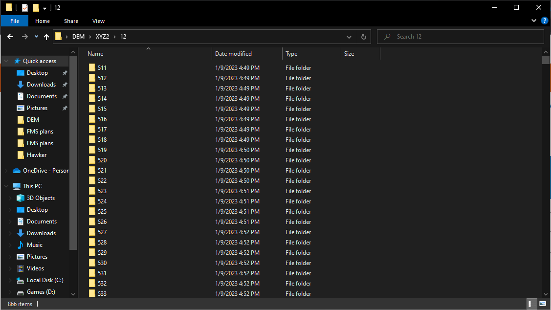

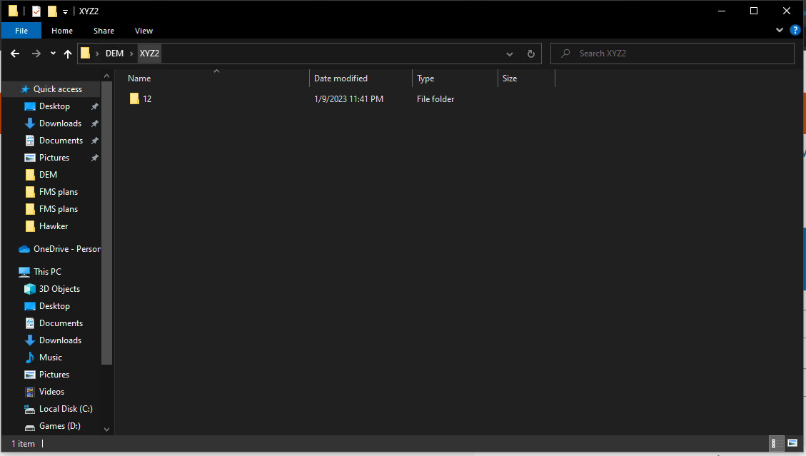

Did you mean to add the backslash in the tile template? It should just be forward slashes. Also the doc states you need to use the level row and column parameter instead of x y z. That might be why. (If you load the layer, you should get a load error telling you exactly this) Also you don't need the subdomain overload, since you don't have a subdomain in the template uri.
So you'd have something like:
private readonly string _templateUri = "file:///C:/Users/Zach/Desktop/DEM/XYZ2/{level}/{col}/{row}.png";
This made it work for me. You can also instead implement a custom ImageTiledLayer, which gives you full control of how the image bytes are loaded. It is more work, but gives a lot better control. Example:
