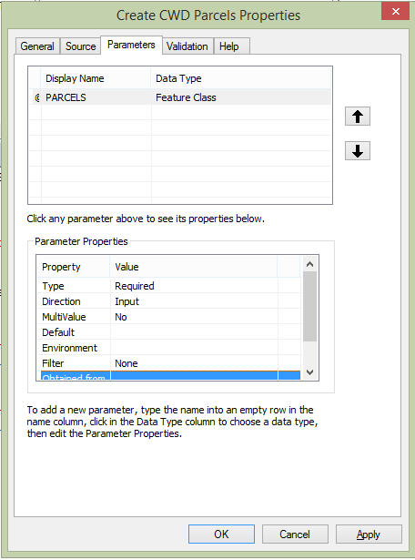

I created a new toolbox with a new "toolset" in ArcCatalog, and have successfully created the 3 script tools using the original 3 Python scripts. The first python script has an input variable defined using "PARCELS = arcpy.GetParameterAsText(0)" in the code. I have also updated the script tool properties to use a parameter for this step (named PARCELS, feature class, required, input).

But if I use the ArcPy module in ArcMap to import the toolbox and call the script, I am not prompted for the parameter, but instead get the message: "Runtime error Traceback (most recent call last): File "<string>", line 1, in <module> File "D:\ParcelUpdates\ParcelToolbox.tbx", line 229, in CreateCWDParcels ExecuteError: Failed to execute. Parameters are not valid. ERROR 000735: PARCELS: Value is required Failed to execute (CreateCWDParcels)."
