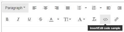

To insert code:

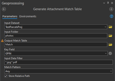

This all seems like there is some confusion about what the tool Generate Attachment Match Table does. The tool creates a table that matches table rows to files based on the files' names and a corresponding field in the table. The output is meant to be used for Add Attachments, to add the matched files as attachments to those rows. After that the output table can be deleted, it doesn't serve any further purpose.
In previous ArcGIS versions, the file name and field value had to match perfectly, else there would be no match. Also, the tool could only do a 1-1 match. If you had multiple files that belonged to the same row, you could only match one of them. If you work in ArcGIS Pro version < 3.1, I have a script here, where I do what I think you want to do. Just replace your paths in lines 1-4 and use GPIN as key_field in line 5.
ArcGIS Pro 3.1 added the "Match Pattern" parameter that makes the tool much more flexible. Just set it to "Any" or "Prefix" and you should get all your matches correctly:
Have a great day!
