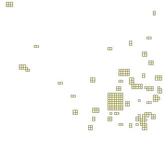

Parameter "area_of_interest" is the feature class created by CacheWorx "Coverage To Feature" Level 19

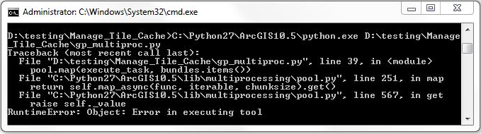

In order to find a workaround I tried to use a script with multiprocessing.
Unfortunately, it has an error at the run time. Please help to make it working.

The error (see the image)
