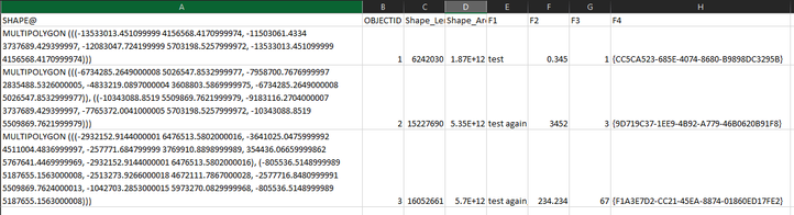

Here is what my input CSV looks like. Note that headers are optionally used, and other fields (columns) can be included, but they will be ignored in the output:

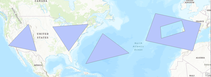

And the outputs:
Note there is a single part, a multipart (two triangles in the middle), and a polygon with internal rings (a hole). This script will ignore headers in the CSV, and it essentially ignores fields other than column 1, which is where the WKT geometry must be stored.
