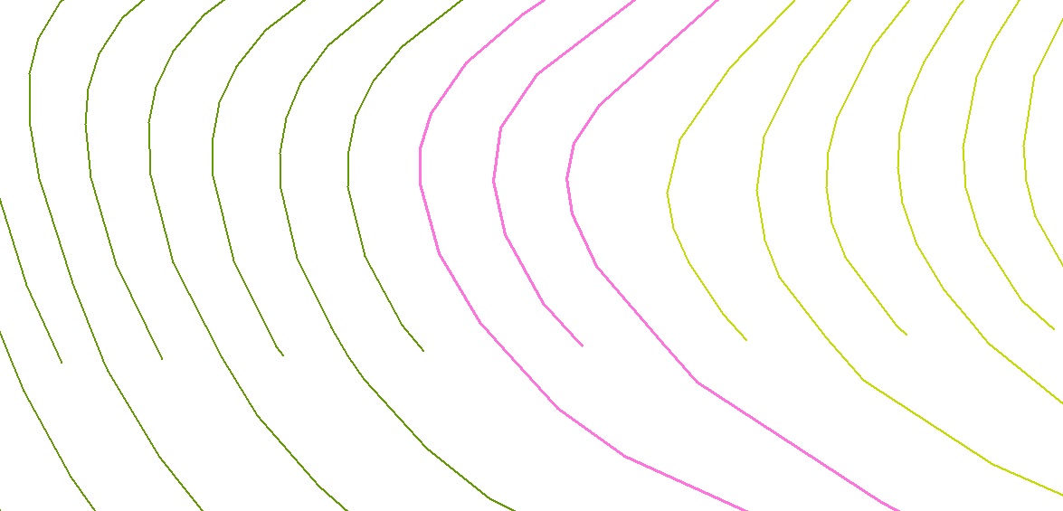

I have some elevation data as contour lines but there are places where the contours just stop. I've been reading about interpolation but they all start with points, is there any interpolation method that I can do using the existing contour lines?  Thanks!

You could interpolate the existing contours, using Topo to raster (Topo to Raster—Help | ArcGIS for Desktop  ,  and then derive new contours, but you will loose precision.

If the incomplete contour lines cause undesired artifacts at the ends you could consider excluding them from the interpolation.
Question: how were these contour lines generated? It seems a little strange that every second line stops at a similar Y (lat) value.

The contour lines are USGS 24k. We need areas above 2500ft (middle pink line in image) but the 2500 contour is missing at certain areas. After reading about interpolation I was hoping that we could create a complete 2500 ft contour.

you can't produce a new contour or extend an existing without re-interpolating

I wonder if maybe a more complete contour data set is available, which would save having to interpolate.  Here's some links that may be of help:
topotools.cr.usgs.gov/contour_data.php

An other way with the extension 3D Analyst is:
1. Make a TIN with the contour lines. The contours are hard break lines in the TIN and every line must have an elevation.
2. From the TIN you can generate contour lines in several Intervalls.
