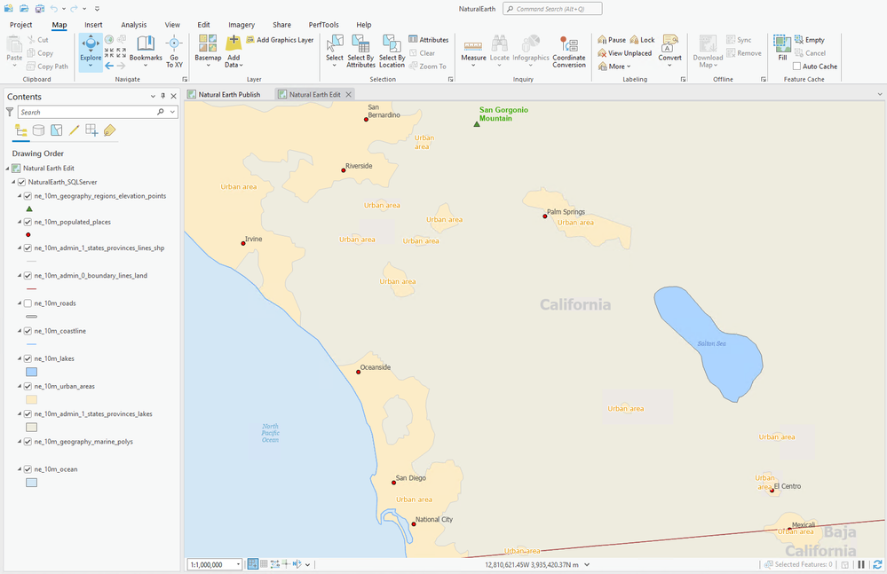

- View of the Natural Earth service from ArcGIS Pro:
The Natural Earth Dataset
The Natural Earth datasets provides some decent map detail (at smaller scales) covering the whole world.

- Zoom in to an area of interest (where the inserts will take place)
- In this example, the area of interest is Southwest of Palm Springs, California, USA
- Insert a new point
- From ArcGIS Pro, select the Edit tab from the top menu; click on Create (under the Features section); then from the list of Create Features Templates select "ne_10m_populated_places"
- Then, click on an area in the map to insert the point

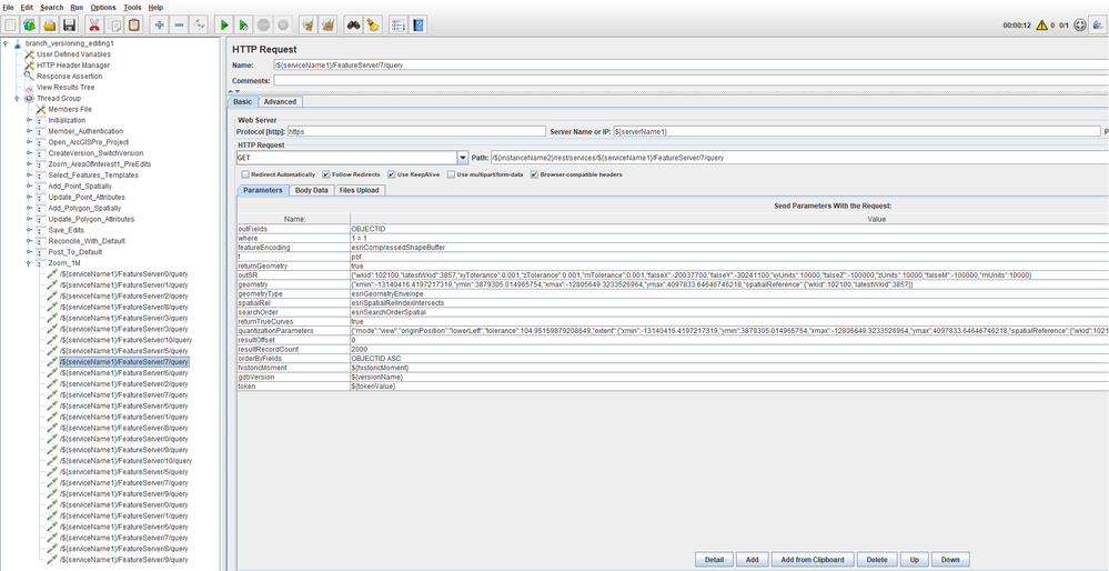

The Branch Versioning Editing JMeter Test Plan
- To download the Apache JMeter Test Plan used in this Article see: branch_versioning_editing1.zip
- Opening the Test Plan in Apache JMeter should look similar to the following:
The tests steps closely follow the workflow performed in ArcGIS Pro:

Components of the Test Plan
In order to help keep this branching versioning editing Test Plan as simple as possible, only a few options exist under User Defined Variables that need to be configured. A single HTTP Header Manager element is utilized and just one Response Assertion exists to throw messages if the word "error" occurs in any response.
CSV Data Set Config
The test does make use of a CSV Data Set Config elements in JMeter to order to authenticated and utilize a different Portal member when executed under load. This item is location inside the Thread Group.
Note: As administrators, testers and analysists, the JMeter Test Plan could be as complex as needed to fit your needs. It is not uncommon to having an editing test have the actual changes (e.g., geometries inserts or attributes updates) use a CSV file to make the effort more dynamic and realistic. However, one of the goals of this Article is help show how the editing can be done by keeping the complexity of the test down to a minimum.
(User Test Thread) Initialization Transaction
Once the user or more accurately, the test thread, starts but before authentication takes place, we want JMeter to generate values for a few items and assign them to variables:
- sessionID
- Used for acquiring locks and for write operations
- Unique for each user's ArcGIS Pro session
- gdbVersion
- geodatabase Version name identifier
- Used to help create the named version's "official name"
- Once created, ArcGIS Enterprise will also generate a GUID associated to the new named version
- A unique name for each named version
- A GUID for our point to be added
- Unique for every added point
- Unique for each users ArcGIS Pro session
- A GUID for our polygon to be added
- Unique for every added polygon
These are defined through a User Parameters element.
Open ArcGIS Pro Project Transaction
When expanded, the Open ArcGIS Pro Project transaction will list the requests issued when the aprx file was launched. There are typically many requests for such an operation as ArcGIS Pro gathers meta-data on the service and layers.
In the middle of this operation are a few requests calling a special GUID resource. These are calls to the default version in the geodatabase. Typically, "BD3F4817-9A00-41AC-B0CC-58F78DBAE0A1" is the GUID associated with Default. There is also startReading request to obtain a read lock that utilizes the sessionID generated earlier in the test.

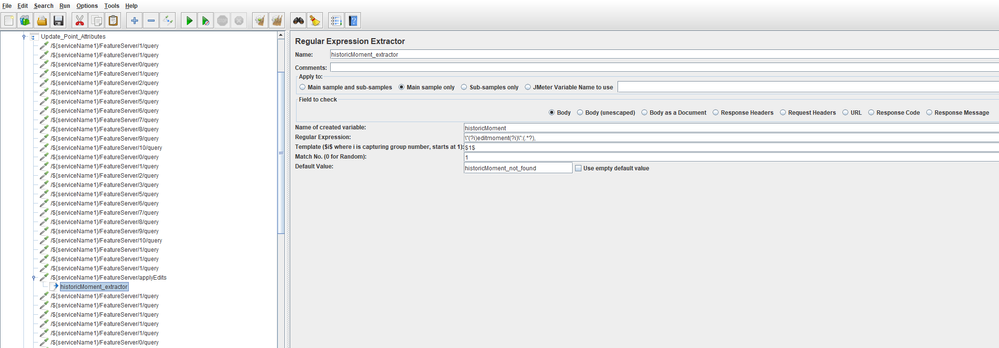

If the applyEdits is successful, a new edit moment is returned to be used on subsequent feature queries.
Note: The value of the new historicMoment key in the query requests before applyEdits is called is typically different than the value after. The value of the property (e.g., historicMoment) is updated through the Regular Expression Extractor element.
After an edit operation, there are often a few feature queries which use the edit moment, version name and ObjectID that was just inserted.

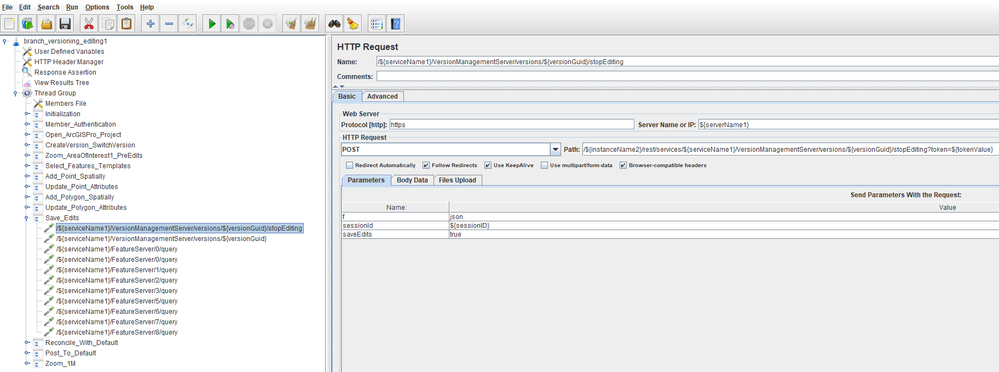

Save Edits (to the Named Version) Transaction
At this point in the Test Plan, the edits are done and the long transaction can be completed. This happens by a stopEditing request being issued against the named version. When the commit is successful, the branch moment value is updated and the edits performed will persist in the named version.

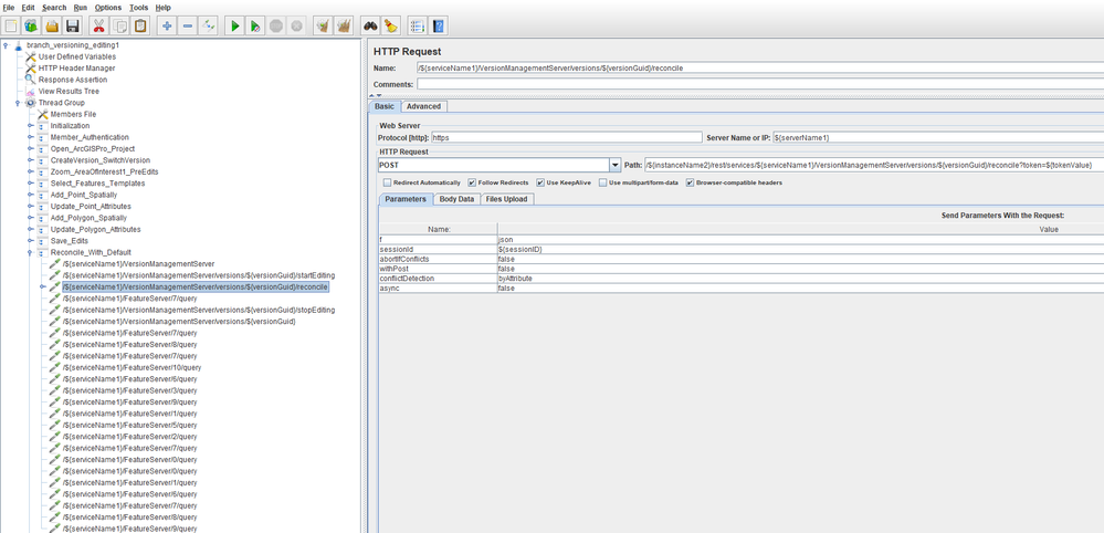

Reconcile With Default Transaction
If the changes made against the named version need to be visible in Default, the reconcile operation must take place first. As mentioned earlier, reconcile helps resolve data conflicts, that might exist between the two versions.
Since a write could be taking place during this process, a startEditing request is issued to the named version GUID resource just prior to the reconcile.
From an HTTP request point of view, reconcile is called against the GUID of the named version (which was created from this iteration of the test). The key/value pair request parameters are fairly straight-forward with the only dynamic pieces being the sessionID (and of course the token).
A stopEditing request is issued (also against the named version GUID) once reconcile has finished.
Once the reconcile has completed successfully, a new branch moment is returned and captured.

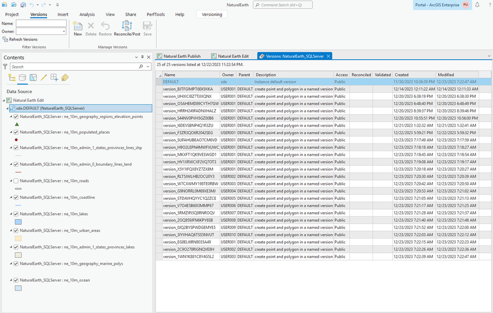

Managing the Named Versions
Named versions can build up over time, but if the post operation is the last action in the user's edit session, the named version could be deleted.
Note: For simplicity, deleting the named version after the post transaction completed was not added to the test.

Historic Moment Testing Details
The branch moment is a critical component of branch versioning as it allows the feature layer queries to pull data from a specific moment in time from the geodatabase.
However, from an HTTP testing perspective, the response from various functions list this value under different string names. Some resources list it under creationdate or modifiedDate, whiles others use editmoment or just moment. As a tester, that is something to look out for when constructing the regular expression to capture the appropriate value. In the case of create (version), creationdate and modifiedDate are returned though they often contain the same value.
For more information see: Historical moments
