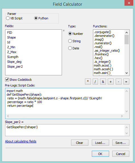

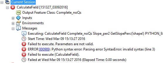

I am trying to calculate the % slope of multiple polylines in a shapefile. I am using Arc 10.1 with the basic licence.
When I run my code in the Field Calculator I get a Python syntax error on line 3. I can't see the issue - can someone tell me where I'm going wrong?
My code is:
NB - I am not sure what directions the polylines were digitised in. Hence I don't know if the last point is at the higher elevation or vice versa, which is why I am trying to return the absolute change in z value.
The error read out I am getting when I run the code is:
Thanks in advance!
CamillaRootes

DanPatterson_Retired
MVP Emeritus
in your expression box, it should be !Shape! with the s capitalized.  Also check your indentation, it looks sketchy.  And you need to pass the !Slength field in as well
CamillaRootes
New Contributor III
I've made changes to the expression box and the indentation. What do you mean about passing the SLength field in?
MVP Emeritus
GetSlopePerc(!Shape!,!SLength!)
def GetSlopePerc(Shape,Leng)
in ration change !SLength! to Leng
CamillaRootes
New Contributor III
Hi again. I've only just had the chance to test these changes but the code is still returning an error.
Here is my current code:
This is the error that it is returning:
Thanks for your other point about the straight line slope. On thinking about it I do think that I will need to use the straight line slope. So I will add another field to compute the straight line distance between the first and last points and will substitute this field for SLength.
